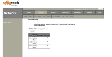

I had a similar issue using my Tenda rounter on Netlinkont (bridged mode). Finally I got a solution. I turned on port binding on ONT and cloned my router’s MAC address to be same as my laptop’s. Now I can connect through PPPoE mode on the router although, I cannot access ONT page now

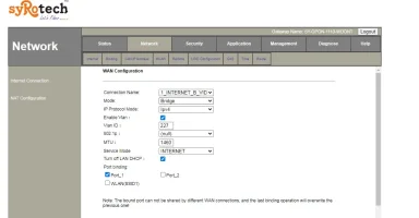

So in a major Victory was able to finally configure my ONT in bridge mode today, although I do have a very noob level question...

DHCP enable only in the device that does all the routing. If you did not bridge, then DHCP in ONT must be enabled. If you bridged, then DHCP must be from the router, because automatically your ONT just does the Optic to Ethernet conversion alone
