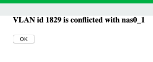

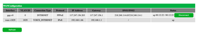

Well, I can't get the voice working. ONT is basically getting a connection from OLT but the details are not right actually. I can't create a new WAN connection because it says nas0_0 conflict. Maybe it's getting the connection from the existing WAN and it won't let me create another on the same VLAN. So pissed of
