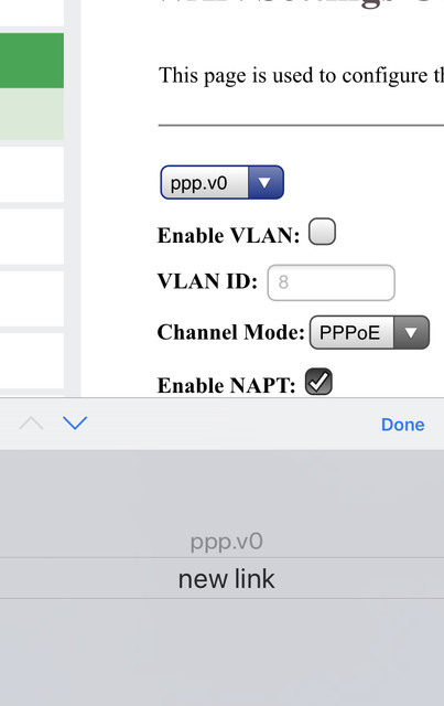

Obviously you cannot have two WAN profiles with the same VLAN id. Why do you have two profiles with same VLAN?
Plus are you sure the VLAN is correct, most users have it as 1830 for voice.
Hi @varkey ofc I don’t want to create a new connection but!
1) As you can see in the first screenshot it’s getting a different IP 192.168.1.xx and ofcourse my IP and gateway both are different.
2) It’s not showing in my WAN as well so I can edit the connection, but nope it doesn’t show there as well.
